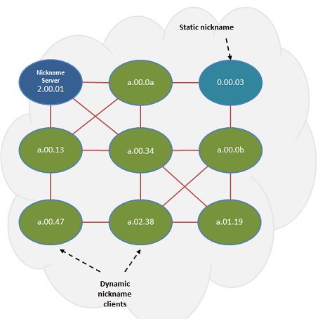

Dynamic Nickname Assignment is a service that provides unique nicknames to compatible switches across a Fabric Area Network (FAN).
You can configure a node in a FAN as a nickname server. The nickname server cannot be started until you configure it with a static nickname. As a best practice, configure at least two nickname servers in a FAN to provide redundancy.
Configure the nickname server with a static nickname that is outside any configured dynamic nickname server range in the network, or you can configure the nickname server with a static nickname from the first 10 values of the configured dynamic nickname server range in the network.
Consider the following information when implementing this feature:
You must configure a nickname server to assign unique nicknames to clients based on established policies.
You can configure multiple nickname servers in a FAN to provide resiliency.
Dynamic Nickname Assignment is not supported in a FAN that contains ERS 4900 or ERS 5900 products.
You can use static nickname assignment and Dynamic Nickname Assignment in the same FAN.
You can configure Dynamic Nickname Assignment using a range prefix that can use a range from 0.00.00 to F.FF.FF. This method provides 256 groups that cover the range of 0.00.00 to F.FF.FF.
You can configure the nickname server with a static nickname from the first 10 values of the configured dynamic nickname server range in the network.
